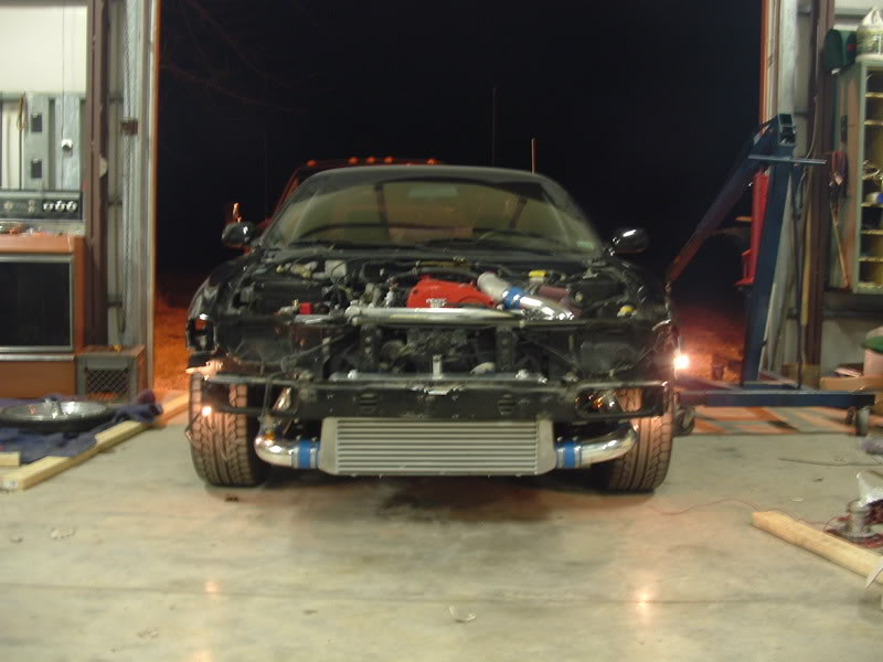

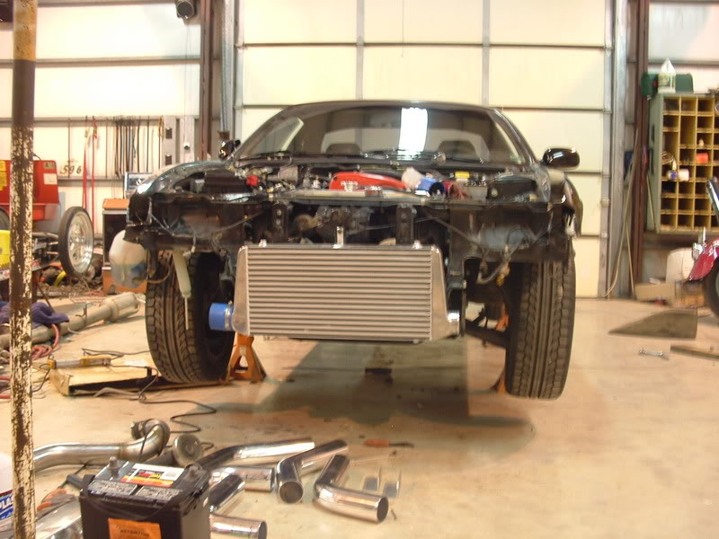

only thing the front mount is going to do is reduce your chances of detonating cause if the better cooling efficiancy and also you might get a little bit of lag. if i were you i would just get the bigger stillen side mount intercoolers but the front mount would look sexier lol. but dont expect any hp gains. just do what i did and get the ebay front mount for $100 bucks or so and make or buy your own ic piping and front mount brakets. heres a pic of my ebay front mount with custom made and welded brackets.
Attachment 1643
Attachment 1644

sorry burnout but my intercooler is a bar and plate style is good for 700hp and it doesnt have barely any preasure dropits a xs engineering core and the shop i bought mine from on ebayjust weld on the end tanks and sell them for what there really worth and not have to pay $500-$900 for an name brand intercooler that does the same exact thing. also yea you will gain hp if you actually add more boost and timing to your engine then you will see some hp gains since its now safer to increase the boostbut if you just slap it on with the stock tune/boost then your not going to gain anything much if you dont use it to your advantage. i would of not bought my intercoolerfor my rb26 if it was as bad as you made it sound then i would of not bought it. but do whatever you want man. on a customers sr20det swapped240sxwe got rid of the oem sidemount IC and installed a fmic and it didnt gain barely anything with the stock tune/boost and he just got a bit more lag since you have alot more space to fill before it gets to your throttle body.
